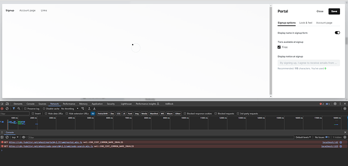

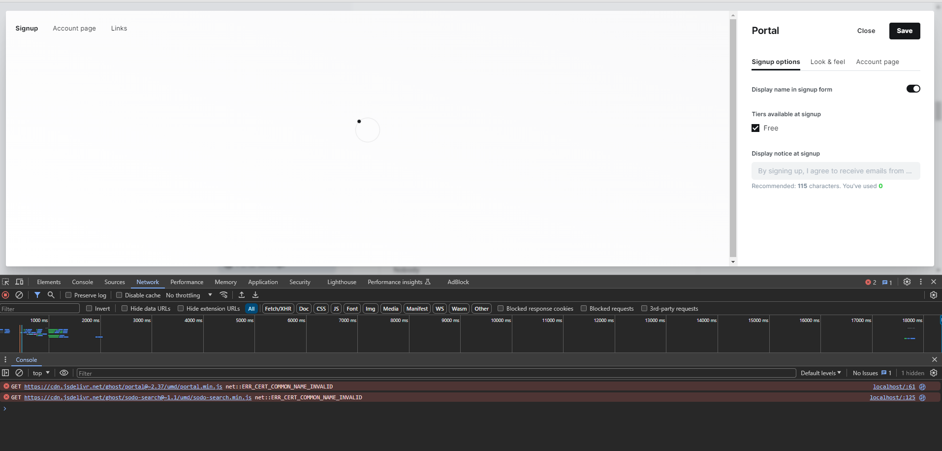

While developing a Ghost theme, I encountered an error related to the CDN used by Ghost. When attempting to access the resources served over the CDN, the following error messages were displayed in the browser console:
  1. GET https://cdn.jsdelivr.net/ghost/portal@~2.37/umd/portal.min.js net::ERR_CERT_COMMON_NAME_INVALID
  2. GET https://cdn.jsdelivr.net/ghost/sodo-search@~1.1/umd/sodo-search.min.js net::ERR_CERT_COMMON_NAME_INVALID
I’ve checked other Ghost themes, and they seem to be encountering similar issues as well.
