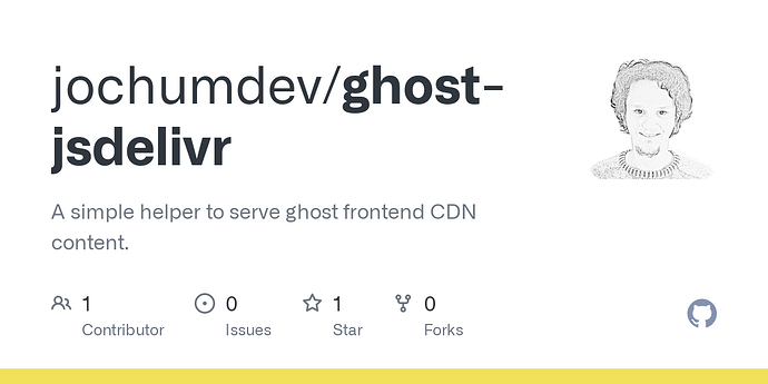

@bjang for self hosted Ghost I found a even better solution :slight_smile:
