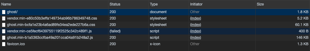

Yes, it looks like the vendor.min.js is not being served OK. The rest of the css / js resources are OK:
