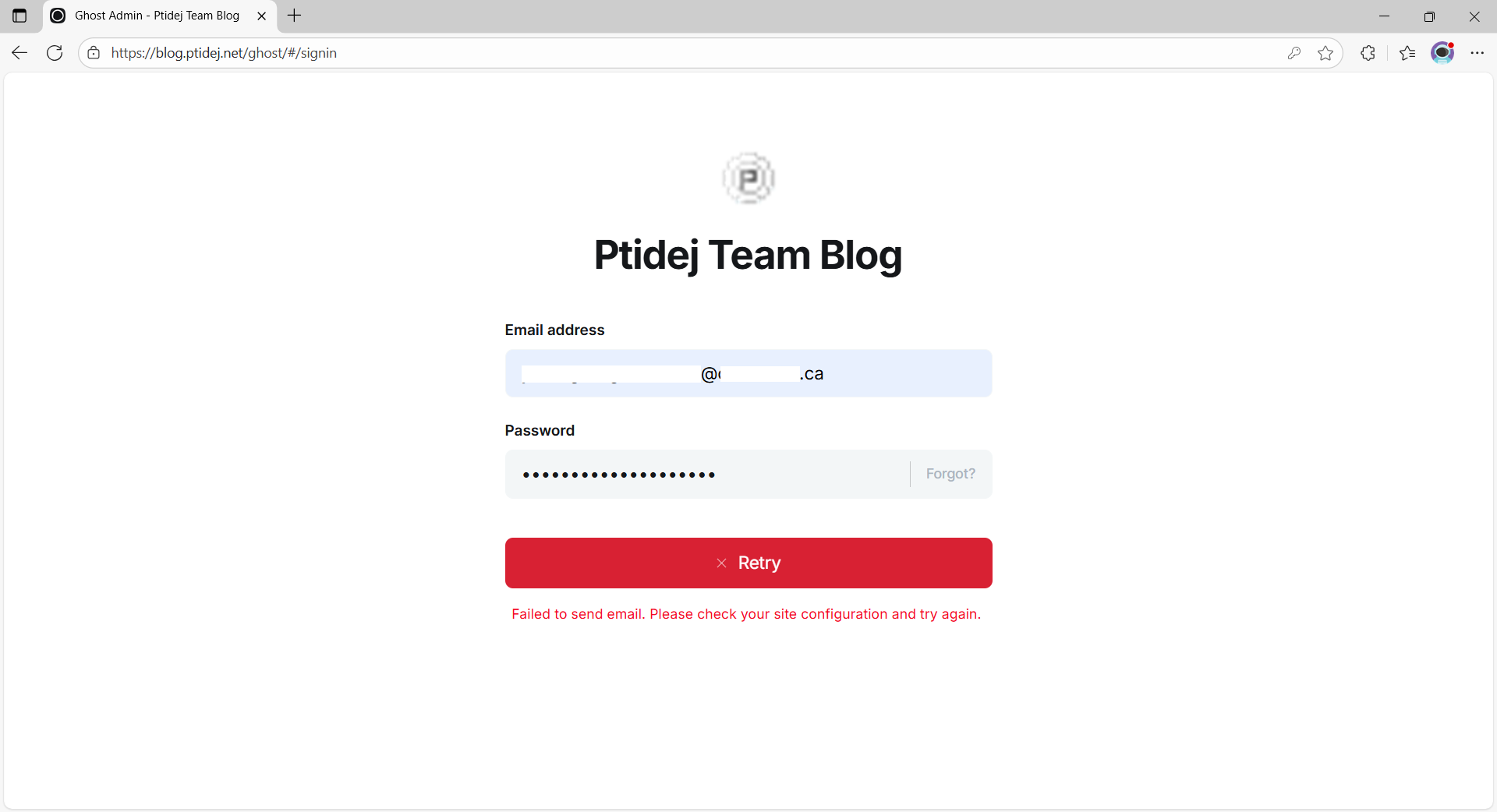

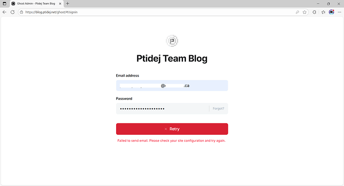

PS. This is what I see when I tried to log-in with "staffDeviceVerification"set to true.
To get yourself logged in (quick fix, not long term solution), set staffDeviceVerification to false and restart Ghost.
