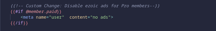

I do it at theme level. In the header code, I put the ad script provided by the ad service provider in this manner.
Now, the ad script that insert ads automatically after a few paragraphs is not even loaded for paid members.
Similarly, I hide the ads displayed in the sidebar.
This is done at site level.
