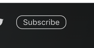

By “subscription emails” - are you referring to member signup/login authentication emails?
The e-mails that we get after subscribing to a blog. I haven’t checked signup/login.
These one’s
