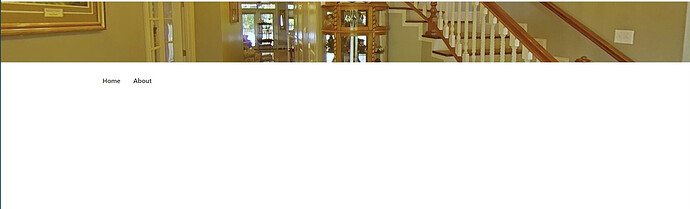

Please help. I can manage to get it to work somewhat, but it’s appearing above the navbar for some reason.
Using this code in my Site Header via Code Injection:
<div class="html-embed-6 w-embed w-iframe"><iframe class="iframe-fluid" src="https://website.com/banner/index.htm" name="Banner" width="100%" height="100%" frameborder="0" allowfullscreen="true" allow="fullscreen; accelerometer; gyroscope; magnetometer; vr"></iframe></div>
Do you have a link to your site? The issue is going to be something to do with CSS (positioning or z-index), but it’ll be hard to diagnose without looking at the code.
Are you going for something like this?
Close, I’m trying to get it to take up the space below the navbar. Specifically where the publication photo generally is (I have that disabled currently) I’ll re-enable it to show you.
