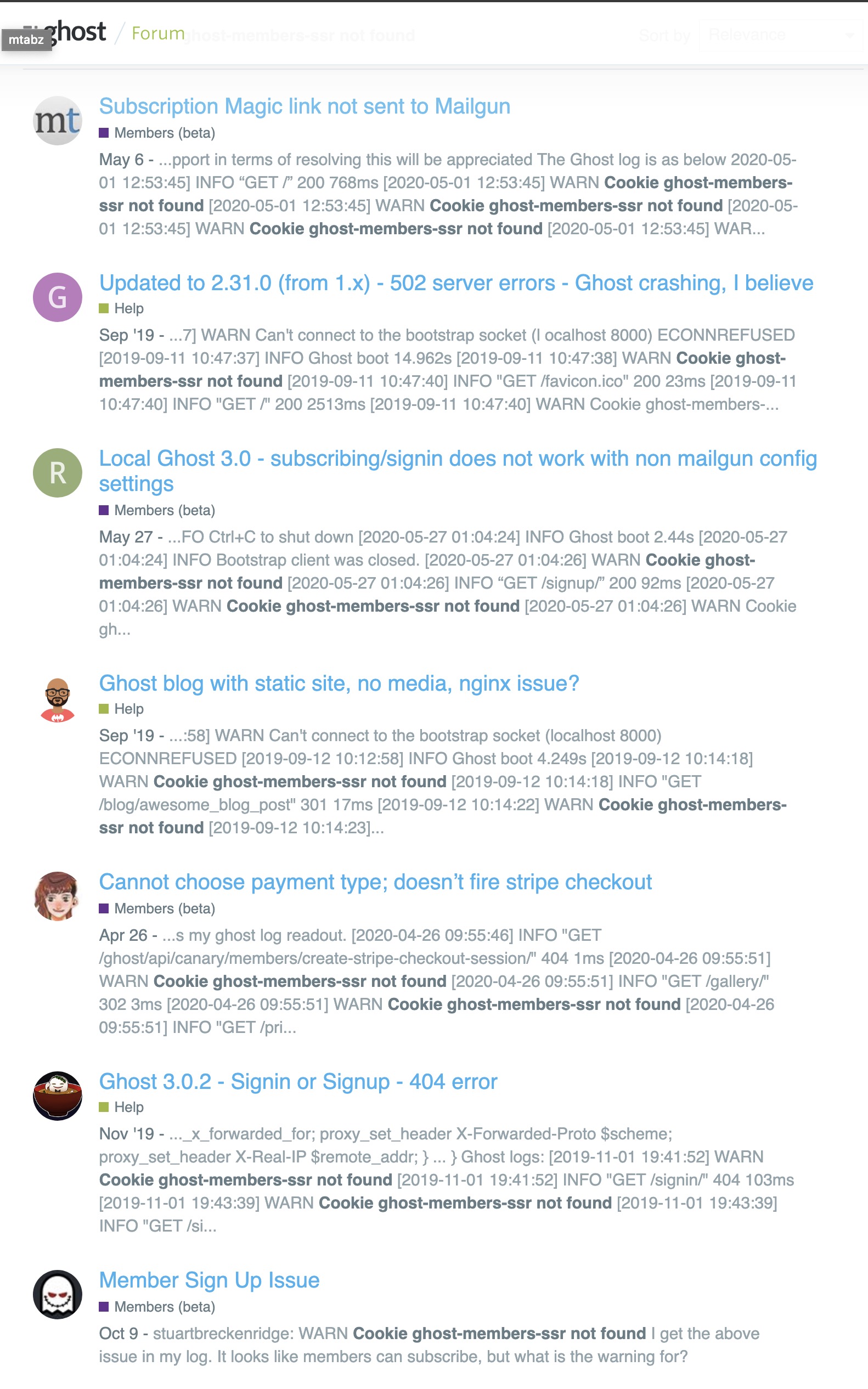

This is a funny one. In my logs I see Cookie ghost-members-ssr not found but everything works as expected.
Question: What does this message means?
logs
Many people has it in their logs:
  • How was Ghost installed and configured? v3.40.1, docker
  • What Node version, database, OS & browser are you using? node 14, sqlite, chrome
  • What errors or information do you see in the console? see above
  • What steps could someone else take to reproduce the issue you’re having?
I think it means Ghost was unable to find an active member because the cookie was not found. As far as I know, ghost-members-ssr is used to authenticate members.
@vikaspotluri123 thank for you reply :slight_smile: I guess my real question is: Do you know how to fix this warning ? Does it has something to do with ads/script blockers on browsers?
I don’t think it’s fixable. If you open the site incognito, I’m guessing you will see that it caused a warning to be printed. I think any anonymous user will trigger the warning.
ok thanks!
