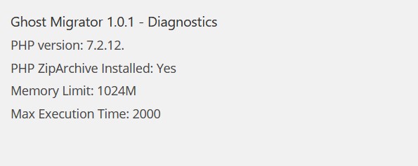

After restarting nginx and PHP the plugin still doesnāt work. Same error, even when I try to download the .json file. It always shows the error after 30s of thinking. I guess there is some 30 seconds value somewhere that has to be edited but I donāt find where, according to the EasyEngine docs it should work. In fact the ghost migrator info shows 1GB memory limit and 2000s execution time, so the problem lies somewhere else.

Regarding generating the zip - I was able to zip just under 3GB in around 20 to 30 min on a shared hosting so 2000 seconds should be a good base amount but if you can, try to increase it some more, maybe try 60min / 3600 seconds.
The PHP max_execution_time does however seem to be reporting correctly so maybe thereās something else on the system causing a timeout. I recommend checking the NGINX proxy_read_timeout value.
