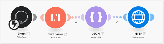

I implemented it with a no-code solution using Make. Here’s the scenario for adding new posts to the Index on Ghost publish…
- Webhook Post Published
- Strip HTML from content
- Create the json object to send to Algolia
- Hit Algolia’s submit API with keys and the json-object
The POST to submit a page to Algolia is
https://{APPLICATION_ID}.algolia.net/1/indexes/{INDEX_NAME}
With two headers, x-algolia-application-id and x-algolia-api-key and the json payload
"url":"GHOST_URL",
"content":"STRIPPED_HTML",
"headline":"HEADLINE",
"objectID":"GHOST_POST_ID",
"description":"GHOST_EXCERPT"
you can add more stuff here, Algolia will happily index fields sent to it. The GHOST_ID is the master key, if you submit the post again Algolia will update the record.
For the initial index build. replace the “Watch post” with “Search Posts” and filter on Status = published. Run once to submit all existing posts and create the index.

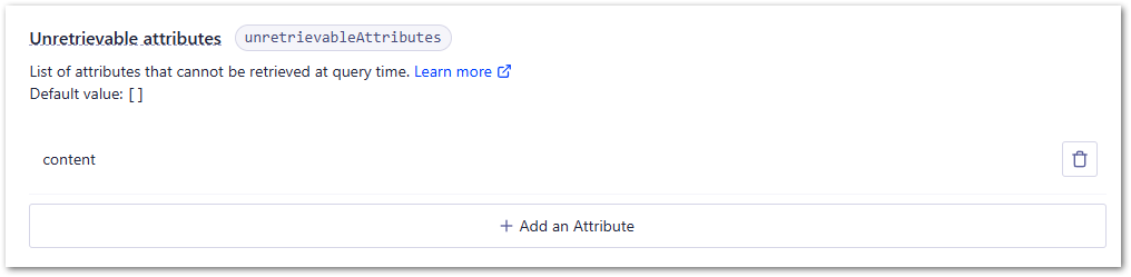

And, as @Cathy_Sarisky writes in the blog post, restrict the HTML content from the API, else bad humans can pull your paywalled content from Algolia, it will still be searchable.
