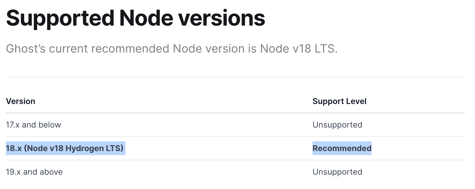

I am using Ghost self-hosted version. Ghost released v5.71.0 and it says they dropped support for Nodejs 16.
So before you update Ghost CLI and Ghost, please upgrade your Nodejs version to 18. The only Nodejs support for Ghost is 18.x (Node v18 Hydrogen LTS)
Source: Release 5.71.0 · TryGhost/Ghost · GitHub
Source: Supported node versions for self-hosted installs of Ghost
