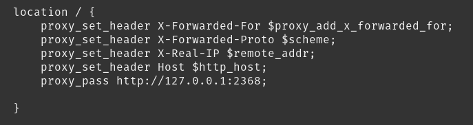

My guess is still, that your port number got mixed up somehow.
Please navigate to /etc/nginx/sites-enabled/yourghostinstancename.conf
Open .conf file with sudo nano yourghostinstancename.conf and look for “proxy_pass”:
Screenshot from 2021-02-01 18-03-04
Note down Portnumber (eg. 2368)
Navigate back to your ghost root folder at /etc/var/www/ghost/
Type ghost ls to check if shown Port corresponds with the Port mentioned in the above mentioned nginx conf file. If yes, good. If not, follow these steps (still in ghost root directory).

@daniel1 Thanks for all of your help. I’d like to see if I can solve this:
Is it possible for me to access the site without the DNS resolving? I’d like to log in and export all of the contents. Then, import it into a ghost pro site.
Thanks!
Im afraid that’s not possible. If you cant reach ghost over the web, you cant export the json file.
Did you manage to find out, if the port is correct?
No, despite your directions, I’m having trouble figuring it out. Thanks for all of your help. I’ll keep trying.
Lesson learned: export the json file frequently and keep offline file of members. This is very stressful right now.
@daniel1 I couldn’t figure it out via the terminal, but I saw the port numbers didn’t match. I was able to change the ports vis SFTP and . . .
I’m back! @daniel1 you are my hero!
