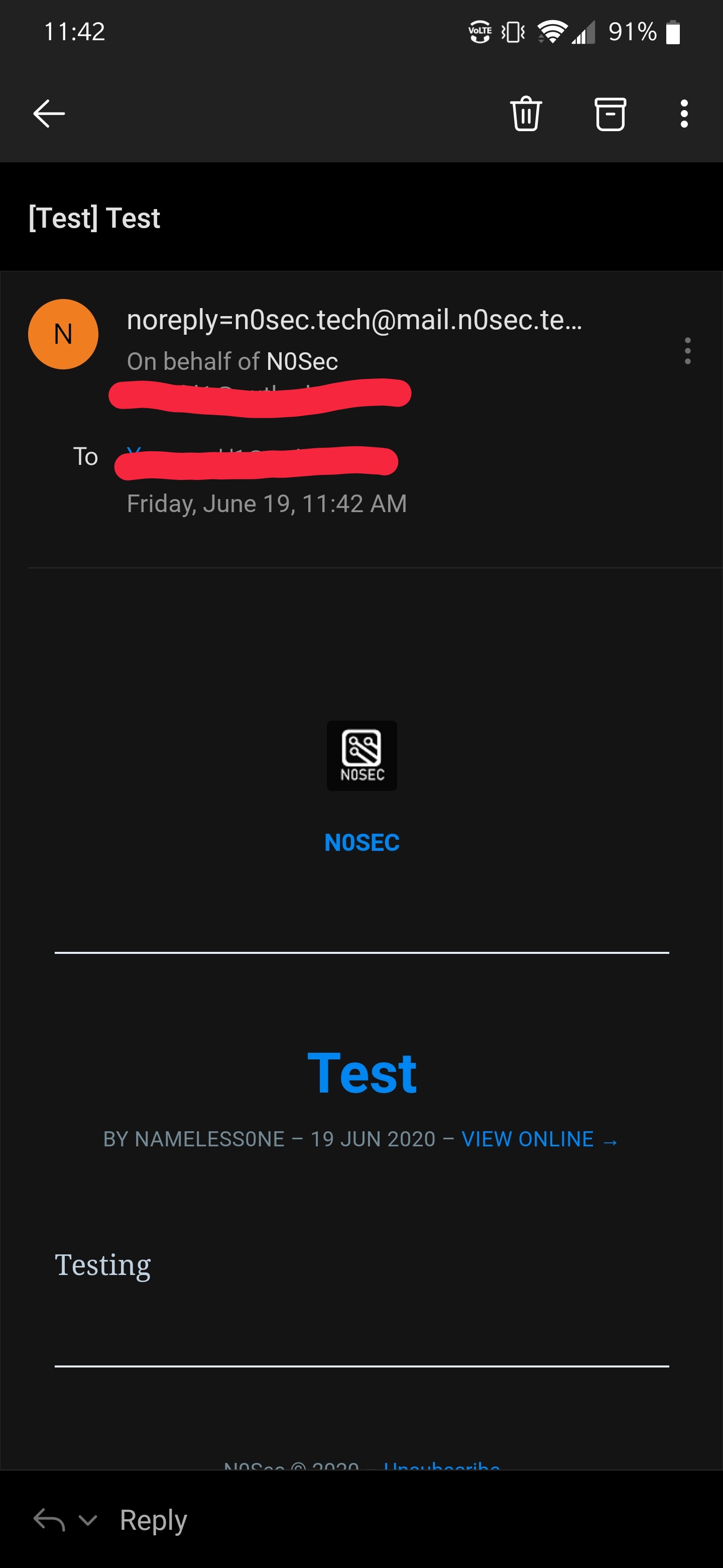

Email Received is a different email than my "From" email in Admin Area
So I’ve configured my Member settings so people can sign up to receive a newsletter. I’ve successfully configured my DNS as explained by Mailgun’s help documents and I am able to successfully receive email from my blog.
However, the problem is that the from address is way different than what’s in the Admin Area. It should be noreply@n0sec.tech but I’m seeing that it’s noreply=n0sec.tech@mail.n0sec.tech. mail.n0sec.tech is the domain I configured on Mailgun and configured my DNS for so that makes sense but why is the first part happening?
Can anybody help me? I’d like it to just be noreply@n0sec.tech or newsletter@n0sec.tech.

That’s what I did. I’m using that From address. But that’s not the address that comes through when an email is sent. It’s noreply=n0sec.tech@mail.n0sec.tech.
That’s what it looks like

It actually does the same thing. I used my gmail address and its now nconkl1190=gmail.com@mail.n0sec.tech as the sender. It does say “On Behalf of N0Sec” and if you follow the link to “N0Sec” it shows my actual gmail address but the From address in the email itself is still strange.
And now I can’t change it back to noreply@n0sec.tech lol.

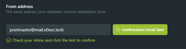

Okay I’ve gone through and configured it just like you said. My user is postmaster@mail.n0sec.tech and I’ve properly configured the json and when I add the email, it works but now I have to confirm the email address. How do I do that?
Also, how would I change the user so it’s like…n0reply or noreply@mail.n0sec.tech?

I can see that it succeeds in the logs but I have no way to get to the link to click on it. Need some help setting that up.

I’ll add in the from part as well. Weird that it worked without it. How do I confirm the email address to be used as a sender? Also, what would my “from” portion look like for me? Is ‘Custom Name’ something like ‘N0Sec’? And what would I put for <myemail@address.com>?
I don’t understand what you mean. It’s not a real email address that you’re sending from, it’s an alias. You won’t be able to receive emails at Mailgun. So what is asking you to confirm your email?

This is where it asks me to confirm the postmaster address

Well, you want your “from” to be from an actual email address. Whatever you use in “from” in your config file, use in that box in your dash.
postmaster@ is your host for Mailgun, nobody will ever see that if you use a “from” address.
So you could use inbox@n0sec.tech or something. You understand? An actual email address, on that domain.
The easiest way to do all of this, is to put your email address into the box for the no reply email in the dash, then set up Mailgun with your API key in the box below that. I’m not sure why it’s asking you to confirm your email address, that hasn’t happened to me.
By the way, that email in the from field doesn’t need to exist if you don’t want any replies coming through.
