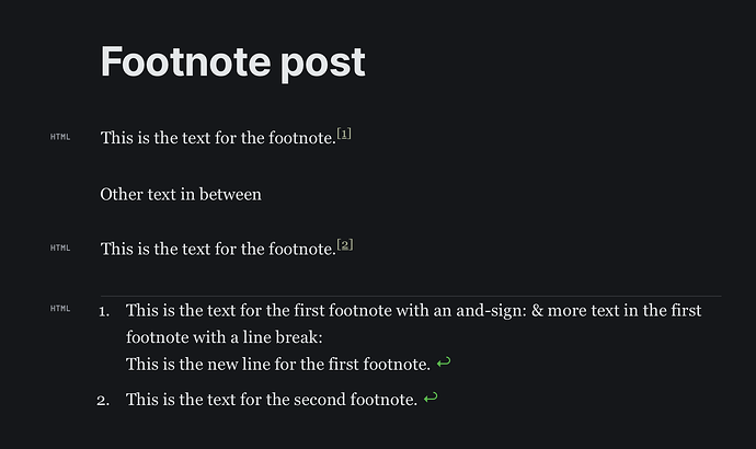

I have absolutely zero coding skills but with 2h of fiddling and try and error here is a workaround that expands on the proposed solution from @Kevin but with proper formatting including backlinking so everything looks neat.
It requires to add an html card at the location for the footnote collection (snippet 2) as well as another html card for every passage you want to reference (snippet 1). In all cards you replace the desired text and edit the numbers for the referencing within the code for each footnote manually (1, 2, 3, 4…).
It’s quite a hastle and subtly disturbing if you’re just a writer and not an ex-Google Tech lead but it solves the problem.

Snippet 1:
<p>This is the text for the footnote.<sup class="footnote-ref"><a href="#fn1" id="fnref1">[1]</a></sup></p>
Snippet 2:
<hr class="footnotes-sep">
<section class="footnotes">
<ol class="footnotes-list">
<li id="fn1" class="footnote-item"><p>This is the text for the first footnote with an and-sign: &amp; more text in the first footnote with a line break:<br>
This is the new line for the first footnote. <a href="#fnref1" class="footnote-backref">↩︎</a></p>
</li>
<li id="fn2" class="footnote-item"><p>This is the text for the second footnote. <a href="#fnref2" class="footnote-backref">↩︎</a></p>
</li>
</ol>
</section>

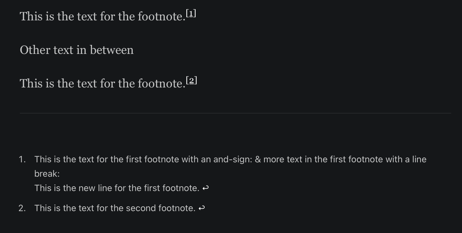

The result looks like this (editor):
And post:
This is a huge improvement on what’s currently required.
At present, using markdown, it is possible to achieve the same, just so long as the whole text of the post is in a single HTML Card, plus there being no additional cards or text below the the single HTML Card with the footnotes (because, if there is, then the footnotes appear above the additional cards or text). So, currently (and fortunately now solved by @kutschkerf), if the footnotes are referenced from more than one HTML Card, then they appear at the bottom of each of those cards. Which is basically such a rigid system that it’s rarely applicable to anything but purely text pages.
@kutschkerf offers a solution that circumvent that ‘single html card’ limitation
It does require a disciplined use of saved Snippets (the Snippets we have been given today by @kutschkerf) on every new post/page with footnotes. Which is not ideal and not as good as pre-2018.
But thank you. This is workable and not too time consuming and allows several cards of different types to be used on one page/post with the footnote references remaining organised correctly at the bottom of the page/post where the second ‘Snippet’ we have been shown today should be placed.
