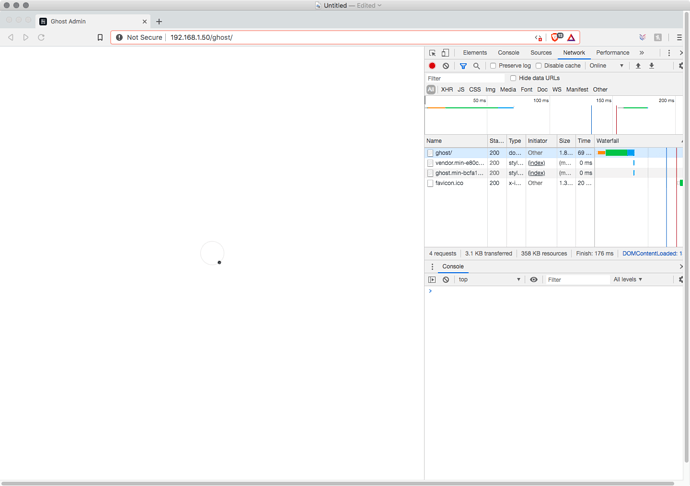

@Kevin I do not see anything in the console tap. I have attached the screenshot here as well. In the mean time, I am still trying to expose the page on an accessible ip but I ran into some internal network issue. I will ping you when I can get that down. Thanks.
@Watt_Poosanguansit your network pane is not showing the admin’s JS files being loaded. Do you have Javascript disabled or are you using something that might be stripping/blocking JS files?
@Kevin Thank you that is the case. My bad just totally forgot that brave turns off js by default. Thanks again for your help.
