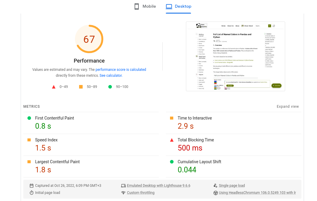

Testing Desktop performance with:
https://pagespeed.web.dev/
Example page:
Problem:
Reduce initial server response time

At that moment I tried to increase CPU from 1 to 2 but there is issue on Digital Ocean side.
So with CF:
CF on Pause:
These are the CF settings:

So results:
disable comments didn’t do any difference.
Disable of members do difference of 10 15 score and improve:
P.S. I’ve did update and restart to the latest version.
Didn’t face any difference.
