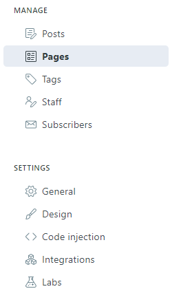

I can’t change the font of my theme inside ghost.
I am currently using the casper theme and I’m trying to seek help on tutorials.
The issue here is: every tutorial I’ve seen is pretty useful, It’s simple code. But, I don’t know how do I access the .hbs file from the theme.
The following image displays the menu I have.
Can somebody please tell me where can I access this famous .hbs file please?

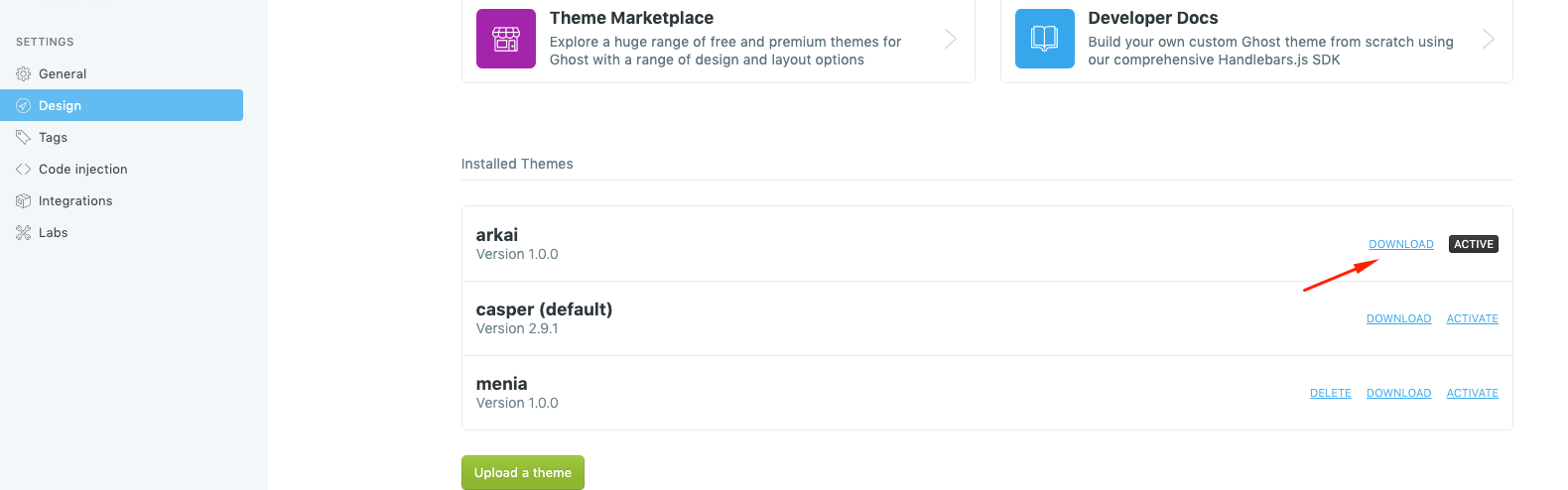

Hi @Jose_Lagunes!
If you go to the “Design” section under “Settings” - you will be able to see your active theme(s). From here you can download the themes, and inside you’ll see all the .hbs
and .css
/.js
files. You can edit this, and then zip them up again (with npm run zip
or yarn zip
) and then upload the theme in the same menu from which you downloaded it.
Hope this help!

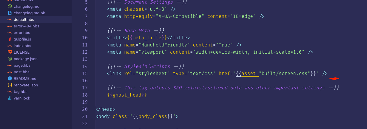

You can easily change your fonts from .hbs
files. If you want that you have to follow these steps:
- Download the theme from
Design
option.
- Open the theme file into the editor and find
default.hbs
file. - Collect the google font link and add that.
- To zip again run
npm install
oryarn
to install node_modules. - Run
gulp zip
- You will get a zip file in
dist > casper.zip
- Upload again the zip file in the site.
Follow the instruction you will get the solution.
