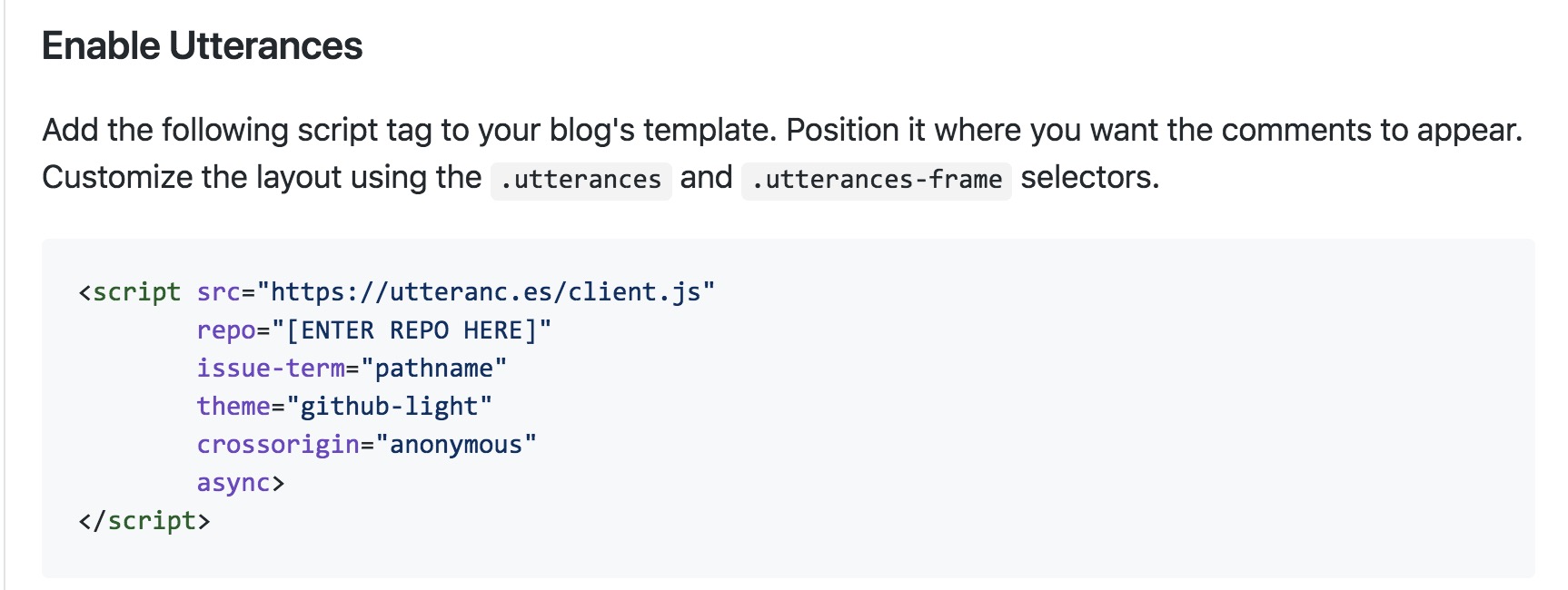

I’m following the setup guide here: https://utteranc.es/ Steps 1-2-3 are done.
Now I need to embed the script:

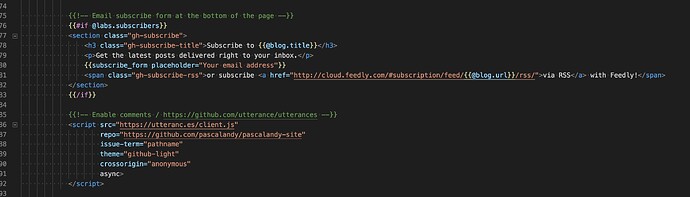

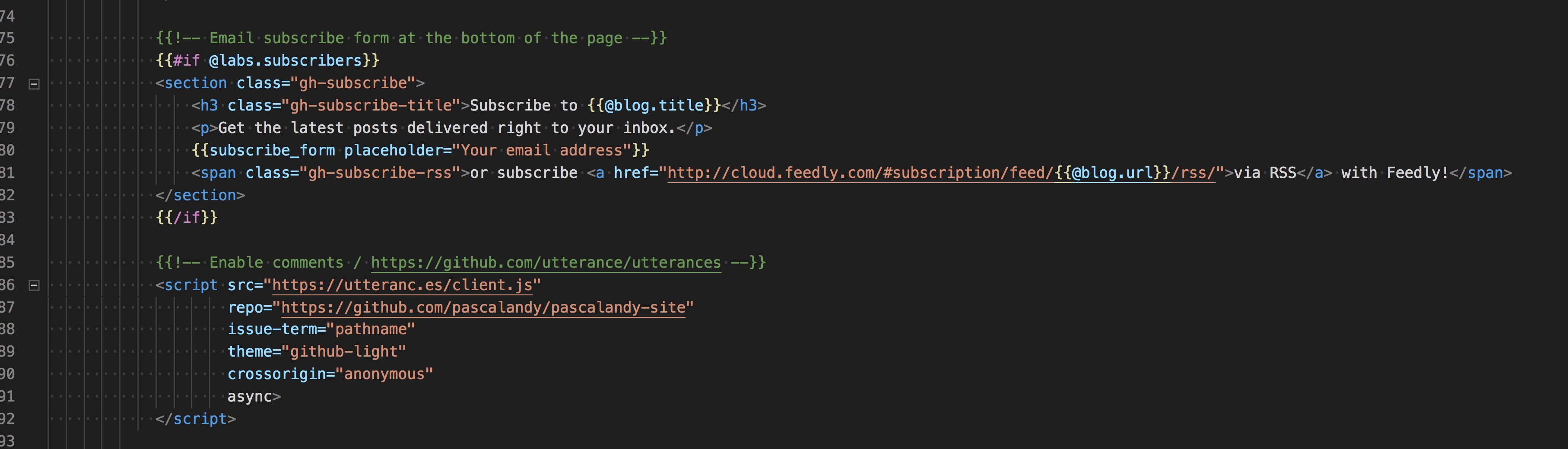

I insert the script in my post.hbs file like this:
I reload a post I have on my blog and I can see the script in the source code:
Nothing
Nothing is showing up :frowning:
Any ideas?

The repo attribute value should be in “owner/repo” format, rather than a full url to the repo.
repo=“pascalandy/pascalandy-site”
@Ayu You are right. Now it works!!
@jdanyow Ah! I missed this one. I would suggest to give a warning or an example :slight_smile:

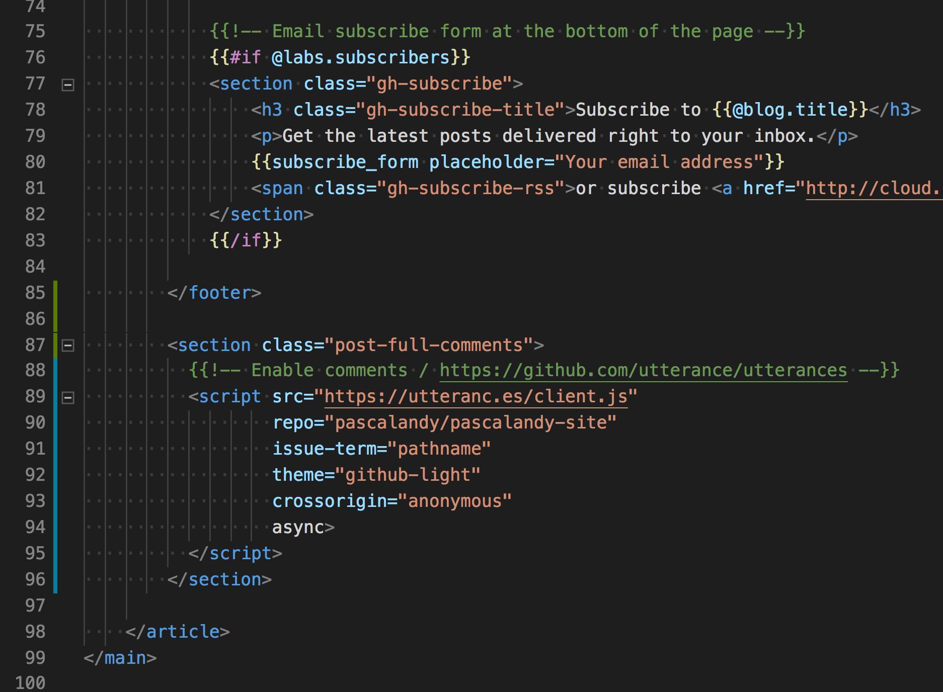

Solution
<section class="post-full-comments">
  {{!-- Enable comments / https://github.com/utterance/utterances --}}
  <script src="https://utteranc.es/client.js"
          repo="pascalandy/pascalandy-site"
          issue-term="pathname"
          theme="github-light"
          crossorigin="anonymous"
          async>
  </script>
</section>
from my post.hbs file:
