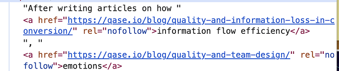

I got an alert about several old blog posts having internal nofollow links. None of these blog posts have been edited recently and we did not manually add the “rel=nofollow” attribute, but when you inspect the pages, it’s there.

This post hasn’t been updated since April and it was drafted with the basic Ghost editor. I don’t see anything in the backend that would add the Nofollow attribute but when you inspect the page, it’s there.
This post was created before I worked on this blog, so it’s possible this has always been there and was only just caught by a crawl. But either way. I can’t figure out how to make these default to dofollow as they should
Hmm, that’s an odd one. Ghost itself has never set nofollow on links so it’s not clear where it’s come from.

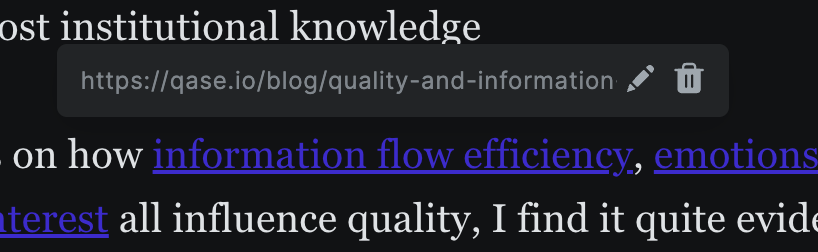

  2. We usually copy/paste from Google Docs but add the links manually by using the add link (see screenshot from the example post, the nofollow attribute is not included)

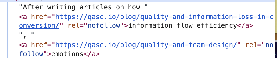

This is so strange because except with the html widget, there is no way to add nofollow links manually, so it must be some bug? Here the first link it’s not just nofollow, but also noopener.
