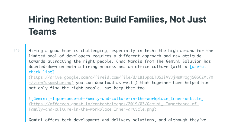

When I publish my post, markdown leaves the &lt;!--kg-card-begin: markdown--&gt; bit in the live version, but it isn’t visible in the ghost admin side… Any ideas why, and what I can do?

We’re pulling it down from the API. I guess the main question would be “why this post”, and not all the others that we fetch and parse in the same way
