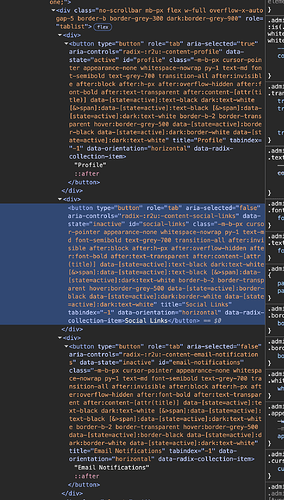

Update:
When I inspect with Chrome I can see that the button is there, but it is missing the ::after pseudo-element to display it.

I feel dumb, after trying another browser I discover that it was my ad blocker that was hiding the button. :sweat_smile:
The reason I was seeing the link in my local install and not on my VPS is probably because my ad blocker is more tolerant with localhost.
