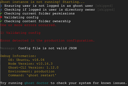

Blog runs as normal tho Ghost claims the config file is funky (see below). I hope that’s not a cause for concern in the future.
