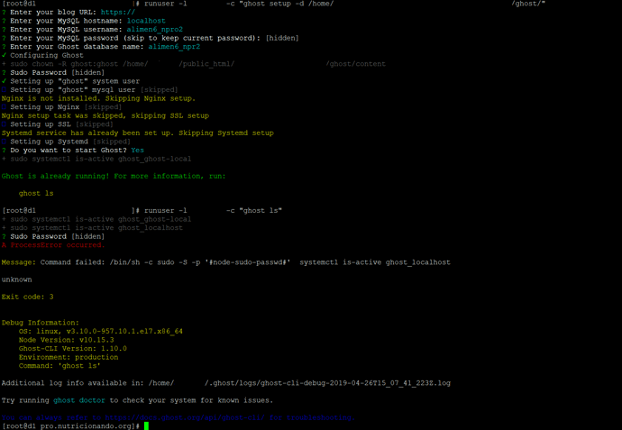

I did the installation usually involves the image below:
When you analyze the Script executed by the Ghost Setup command, it checks the Active Ghost Service using the command below:
- systemctl is-active ghost_localhost
And according to the image information the service does not exist, but in the meantime the thing is strange.
Because when I used the Ghost Install Local command and the service created was not ghost_localhost but ghost_ghost-local.
Follow the image with the service running:
Link: Sem-t-tulo99 hosted at ImgBB — ImgBB (Can I just send a picture here? O_o)
If there is any subroutine in the Ghost * command to override this incorrect service check or inform the service type, it would be interesting and would deminute the maintenance time.
I imagine the service name is related to the type of installation (Ghost Install or Ghost Install Local), correct me if I am wrong.
But I’d say it’s pretty damaging to productivity, as I’m running an instance running multiple sites with Ghost and not using Ghost-Cli commands because of that incorrect service command.
