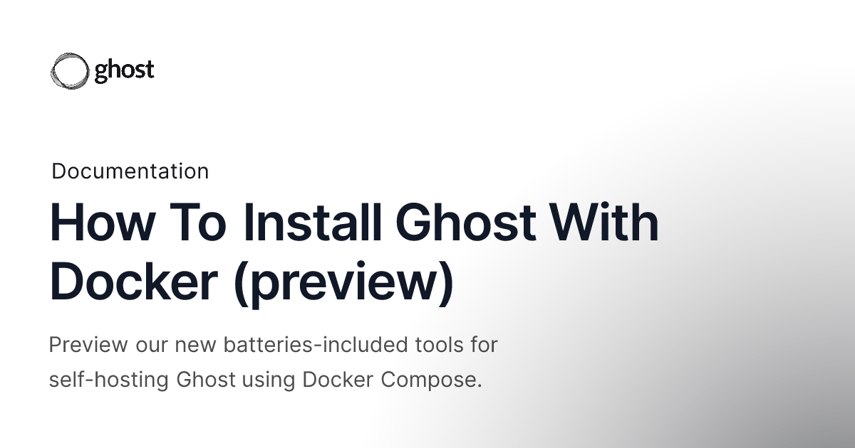

Small side note: rather than the Notion document (which is not official, and probably more like internal notes), I’d follow the official guide here:
So my question was right: is Ghost published too early. For me, it seems that not all necessary to-dos are done.
As a side note: In How To Install Ghost With Docker (preview) - Ghost Developer Docs the notion doc is referenced.

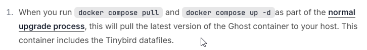

Getting a bit off-topic (mods, feel free to split this), but: Tinybird local is not an official way to have Tinybird running. I have that set up for now, but the “official” self hosted way is to use Tinybird Selfmanaged Regions.
No. Umami and most other third-party analytics tools are a lot more advanced. Though, that can and probably will change in the future.
For now, the big benefit is having everything inside Ghost, and it mainly serves people that do not have an analytics setup yet.

That ends up linking to the TinyBird Local, so I imagine it is the official way at the end. :wink:
Sorry for the off topic, I will open a new topic with my experience hosting local tinybird.

Firstly, your OP is linking to the Notion document which we shared prior to the 6.0 launch. The final version of the documentation is here: How To Install Ghost With Docker (preview) - Ghost Developer Docs - it’s not a lot different, but it is getting added to as we learn things where as the Notion guide is not. I’ve retired to the Notion guide now to reduce confusion.
Secondly, the Docker-based self-hosting setup is marked “Preview” - that is it expressly called out as being an early version. There’s a chicken and egg problem with self hosting tools like this - they have to be used widely by a lot of people with different environments in order to find out which are the most valuable different cases to solve - but that means sharing a happy path version early BEFORE you know what all the problems are and that causes friction for people expecting the finished product.

the notion guide is still linked here:
and here
And here
and here
And probably on more places…
Fixed: Updated internal links in Docker docs · TryGhost/Docs@5c06740 · GitHub
