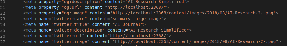

I did, still my index.html is like this:
Screenshot%20from%202018-09-17%2018-20-31

![Screenshot%20from%202018-09-17%2018-20-31|690x111](upload://gCkGUbv78uCRaSPfYGUcwae6OI5.png)

Thanks, I did. But it still gives me Screenshot%20from%202018-09-17%2018-20-31
