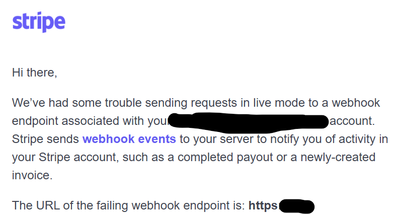

I just got the following error email from stripe and I don’t know why and don’t know what to do. I did have a paid subscription a couple of days ago going through just fine.
Any ideas?

I’m getting emails from stripe that say it’s not receiving webhooks from mysite.com/members/webhooks/stripe/

Is this the email you got from Stripe?
You’ve got the order reversed then. Stripe is saying it cannot deliver webhooks to Ghost. Yes, that url doesn’t work if you visit in the browser, because you aren’t delivering a webhook payload. That’s not meaningful.

Stripe’s email tells you that one or more webhooks didn’t get delivered. If you read the rest of the email, you’ll be able to find out how many time it’s happened, and when it started, and what the error code is, which might provide some extra clues.
Hey, thanks for responding! That’s the exact email I’m getting. ![]()
I’m a newb here so I think I set myself up with this problem in hindsight. After looking around on the Stripe Dashboard I noticed that I have 2 webhooks going to the same URL. One has failed 100% of the time and I’m guessing is from a previous Ghost installation attempt that I messed up by a marvelously dumb terminal command mistake that I don’t want to talk about (ahem - newb here lol) the other seems to be working. (At least most of the time… I’m guessing that a few random failures are just a fluke??)
