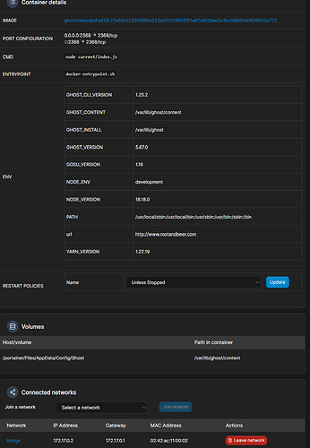

i modified the config.development.json and the config.production.json URL to say https://www.rootandbeer.com I then restarted the service and it didn’t fix anything.
There are a number of factors why that can happen in your setup – the most likely being that these files aren’t persisted on a volume.
I am running Ghost instances in Docker and Portainer myself, but each setup is different. As mentioned, would be great if you could just show us how your setup looks like, in order for us to help you for your specific case, rather than poking into the dark :slight_smile:
just posted it above!
Just saw your other post with the screenshot.
You can see all the ENV (environment variables) you have right there. There is one called url that is overwriting the stuff you have in the config.jsons. Go to the editor of your stack in portainer (Stack → select the stack you’re editing and change it there). This is where you’ll need to change the URL.
There is no ghost stack in my portainer. Its only in the container section. I had to recreate the container, but it’s working now! thank you!
