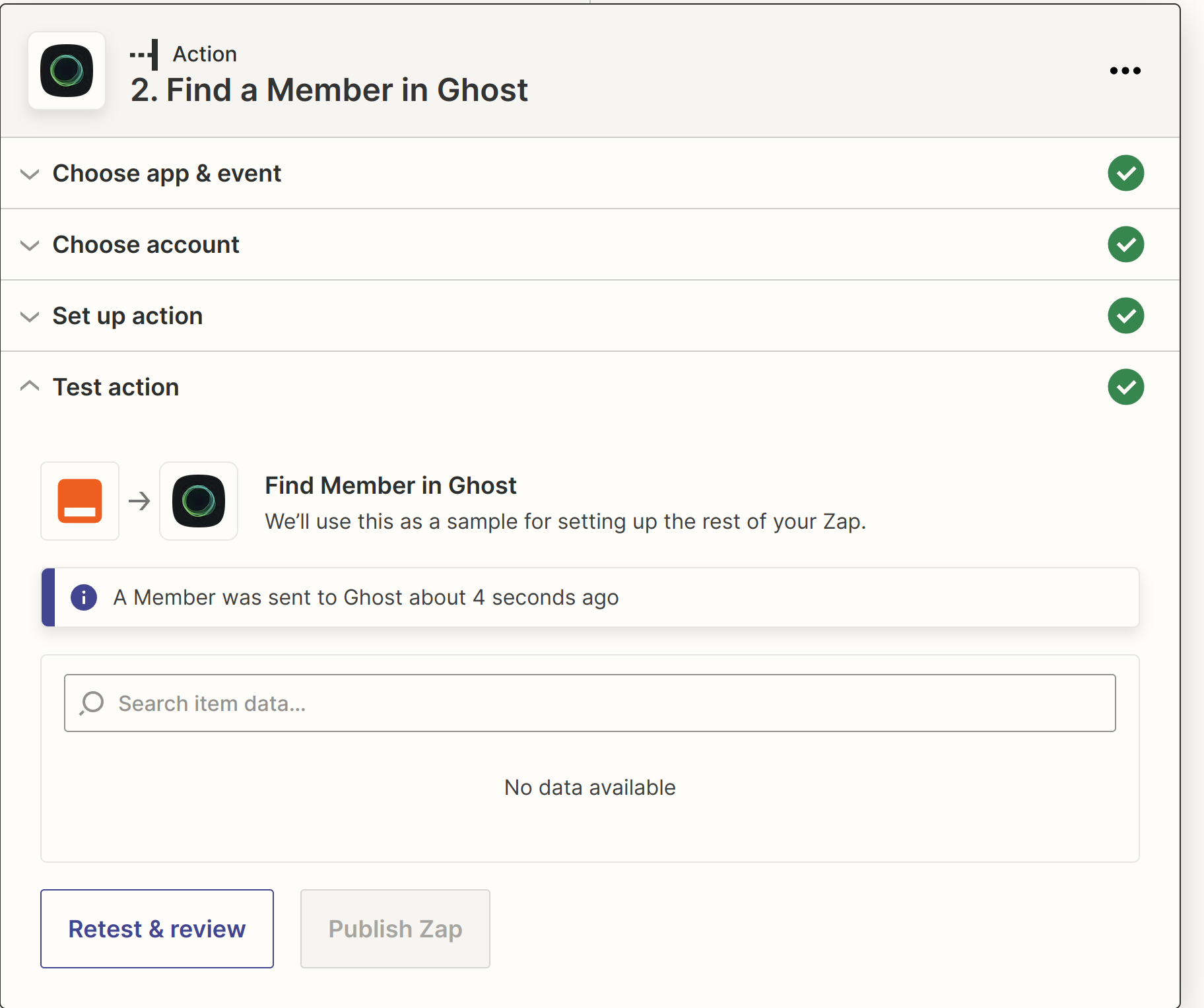

Using the Find Member in Ghost action in Zapier - I do not get any data returned ever.
  • Using a valid email with existing member - no data
  • Using valid email for no member - no data
  • Using random string - no data
I do not get any data or errors. Same response every time:

I was trying to do a Ghost create/update to allow users to subscribe to additional newsletters via our non-ghost website.
It shows that this data should be available but nothing is ever added after the Find a Member step:
Also I expected the data to be the same as the Admin API but am not sure why the list of newsletters is not available.
I would also expect that entering a random string as email, i.e. “alsdkjf”, would return an error in the test of the Find Members but it succeeds silently. Testing the Find a Member step does not return any data regardless of what input I use.

The Ghost action - Create (or update) member. Was trying either, anything. But it doesn’t matter what I put after it. The find member just isn’t returning data in the test step.
Here is a simple reproduction - I would expect this to fail
Instead it returns “no data” and goes to the next step

Even when I add another step - no data comes out from Ghost (see “No data” in To field of Gmail step)
I don’t currently pay for Zapier so am unable to actually publish multiple step processes. I was seeing if it worked setting it up before paying. But am unable to even test the whole process because Ghost Find Member does not ever result in data output.
