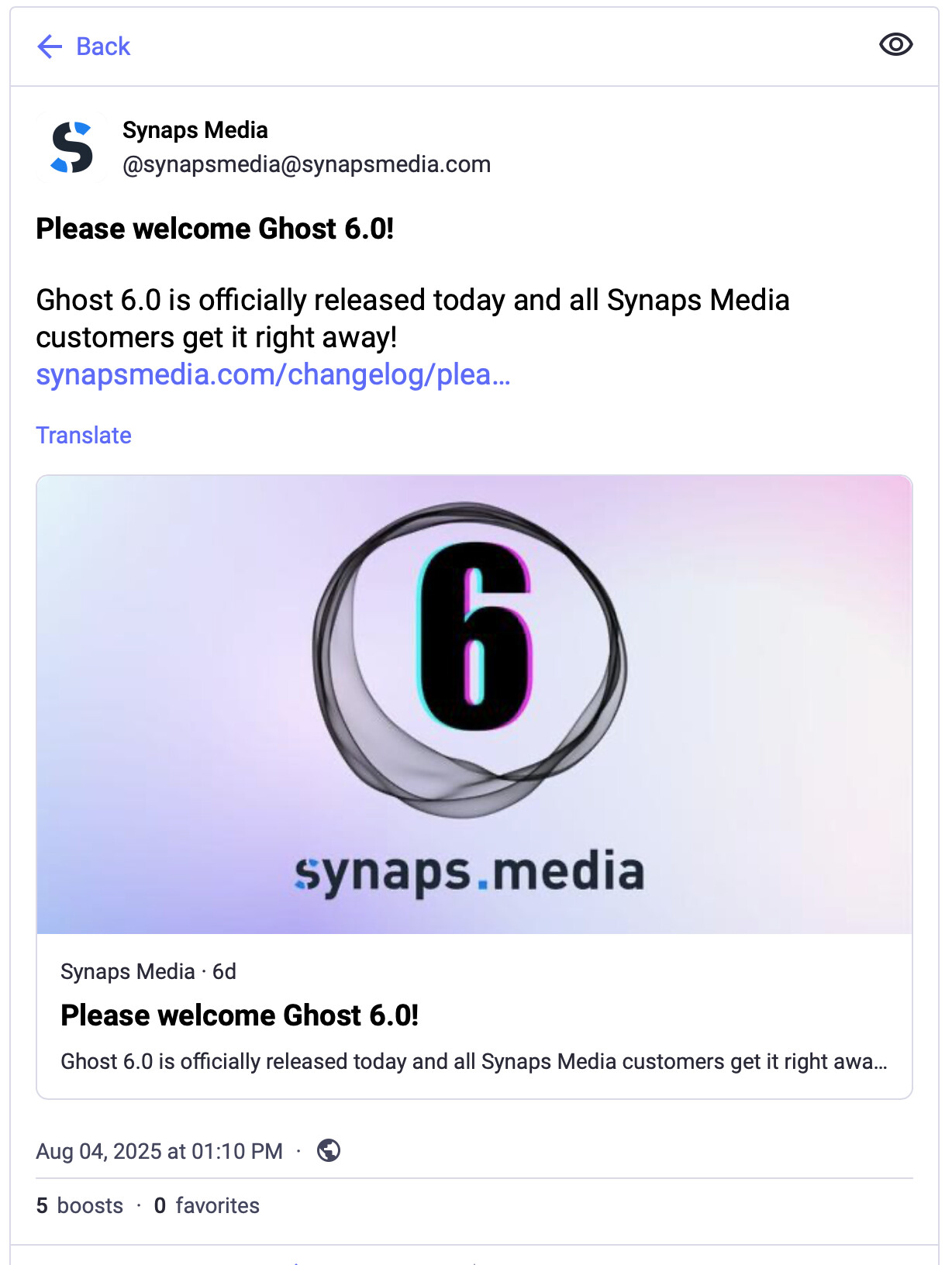

That’s already the case. The full article that you see on your Ghost Admin, is a feature of Ghost’s Reader experience, and it’s dynamically pulling article from your website’s Content API and it respects your content visibility settings. If it’s a paywalled content, even your Ghost subscribers will not able to see the full content.
But normally, actual activitypub post is consists of just title, excerpt and the link. Here an example screenshot of a post seen on mastodon.social, which is an automated article from my Ghost site:

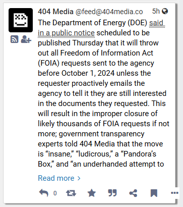

Well, that’s interesting. I just looked at the 404 Media feed from over on my Mastodon to compare, and that same post looks like this:
where the “Read more >” is inserted by the server, and clicking on it expands the post to the complete multi-page text of the article.
