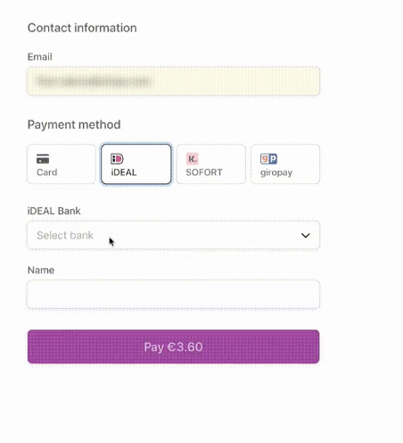

In my ghost instance I can also get the SEPA direct debit to appear, not the Ideal one. The ideal one would have the pink ideal icon in it. such as the next picture:
