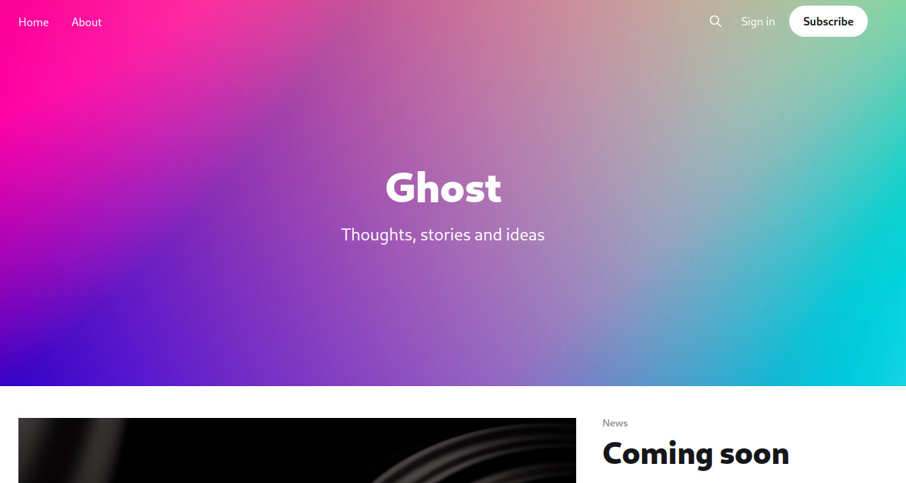

Once this is done, if I navigate to the webroot for the ghost blog, everything loads as expected:
