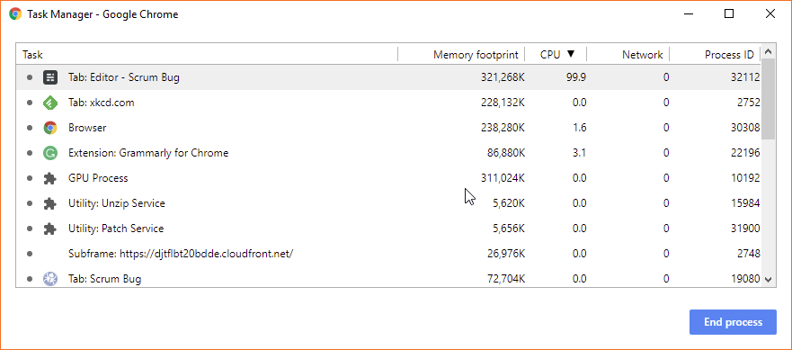

New issue in Chrome with Koenig and Grammarly for Chrome enabled the CPU just spikes:

Grammarly is not currently supported, it has conflicts with mobiledoc-kit’s MutationObservers. In 1.24.3 Grammarly will be disabled for the Koenig editor.
Hopefully it will be possible to add support at some point in the future but it will require an upstream fix - community help there would definitely be appreciated ![]()

Disable Grammarly to fix high CPU usage
