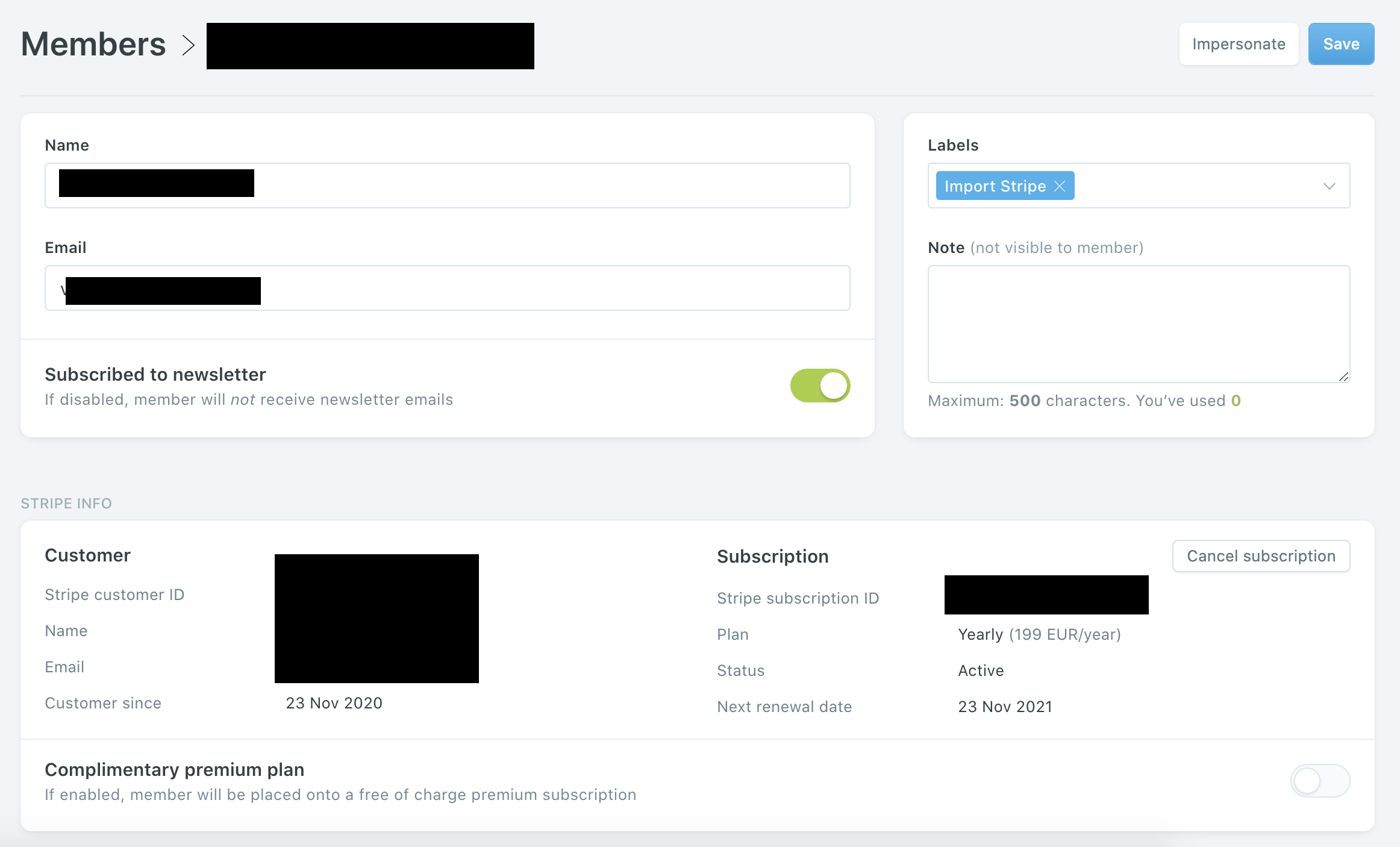

Their account seems to have no problem. They were both imported from Stripe (as most of my users), one had some difficulties on a previous payment. I can impersonate their account. One has a Gmail account, the other one have a company account.

Here is one their profile.
