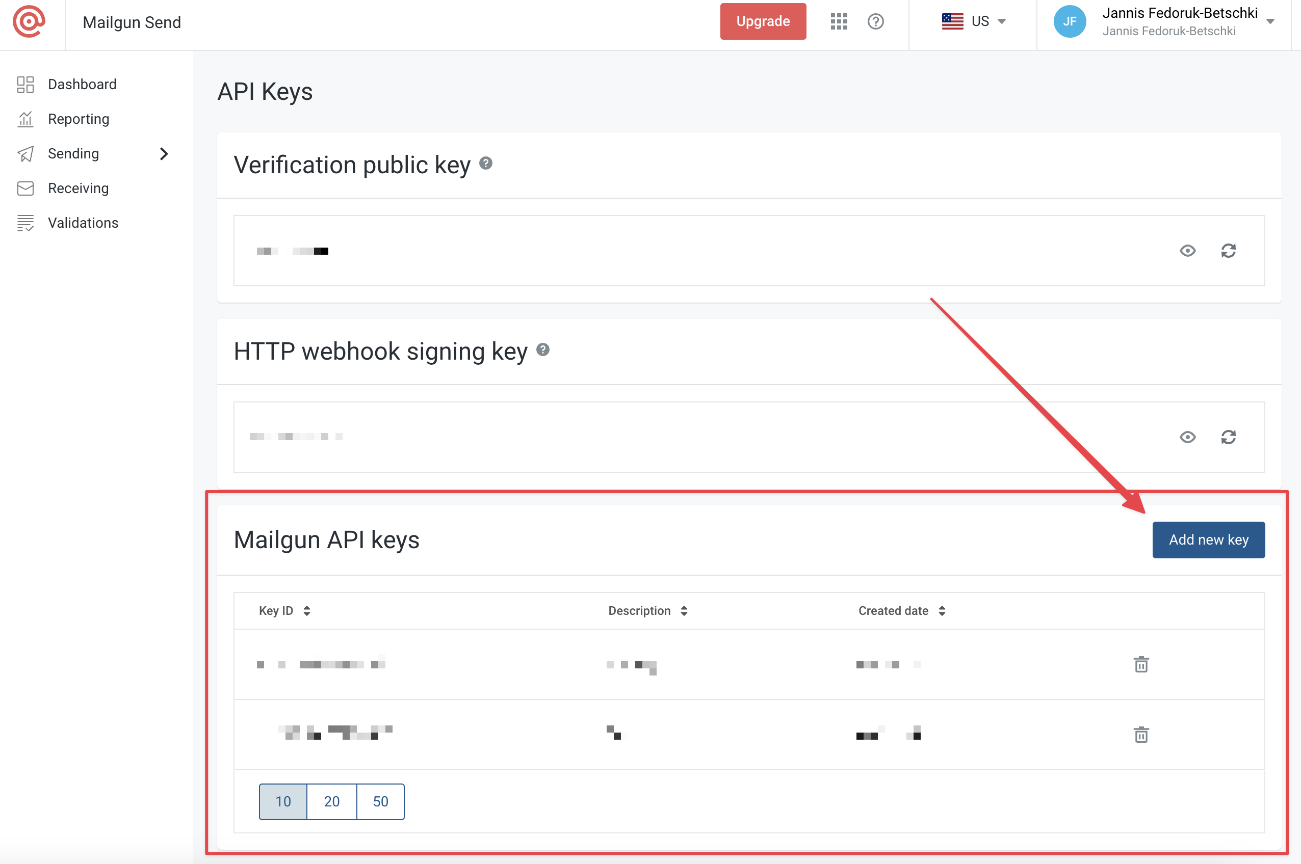

When setting up mailgun, I watched a tutorial video. In that video, a private API key was used when inputting an API into the Mailgun menu within Ghost. I never saw a private API key, and was advised to create one. I wonder if the issues begin with me not ever seeing a “private API key.”
When you go to your Mailgun API settings, you should see three things: “Verification public key”, “HTTP webhook signing key”, and “Mailgun API keys”.
It’s the last one that is relevant for Ghost – so yeah, if you don’t have one set up yet, you’ll need to create one (since Mailgun does not create one out-of-the-box).
Did you do that and is that the key you are using in Ghost?
