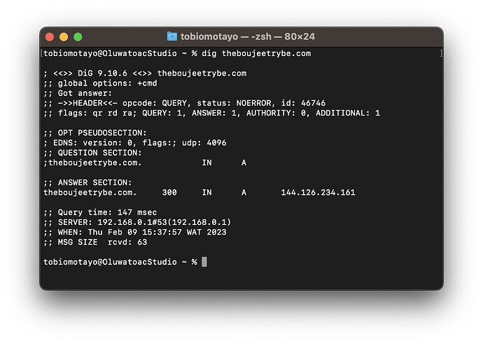

Yes I have completely disabled Cloudfare since the last reply.
dig theboujeetrybe.com returns the IP of the server itself.
Usually websites only have a single IP unless they are behind a load balancer.
Are you sure both those IP addresses are for the server? Can you SSH to both of them?
Oh that’s true. Didn’t pay attention to the the two IPs. For some reason I’m not sure when that IP was added to the DNS and points to the same domain.
I have removed the second IP from DNS and just kept the one for the Digital Ocean server where Ghost is installed.
