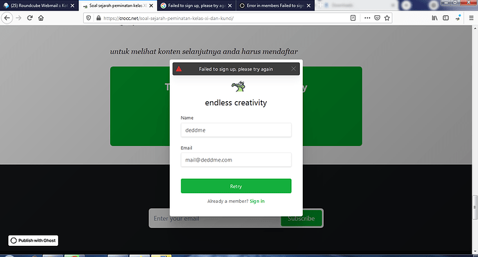

When I try to signup it gives the error " Failed to sign up, please try again Members "

I’m encountering exactly the same problem right now. Were you able to solve it?
The email settings don’t seem to be an issue since I’m able to send test emails for posts.
I’m using the latest version of Ghost and the Dawn theme.

site : https://crocc.net
