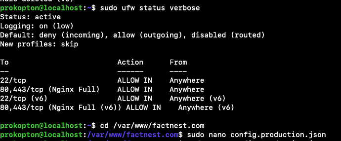

  3. If using ufw firewall: $ sudo ufw allow 587

You definitely don’t need to change your firewall - the connect to mailgun is outbound so poking a hole in your own firewall is a bad idea.

It turns out that it was Linode’s restriction on ports 25, 465, and 587. I sent them a support ticket and they opened port 587. It works now!
